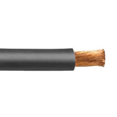

I think we have general consensus here that the OP should use at least 4/0.
The original question was about the automotive ampacity tables being different and confusing.
I prefer hard math numbers like I posted above, or actual test experiences like @scrubjaysnest
It might be better to use actual electrical code tables.
I wont even pretend to know USA codes but I know they will be close to Canadian codes.
We should try to keep our voltage drop around 3% - maybe 5% max.
But 5% at 120 volt is only about 6 volts, but 6 volts on a 12 volt system thats intolerable....
There are also de-rating factors to consider for the cable based on types of cable and application even duty cycle,,,

But that all said no one ever got in trouble for running a bigger wire.
