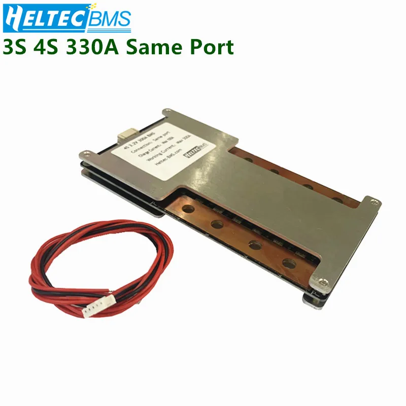

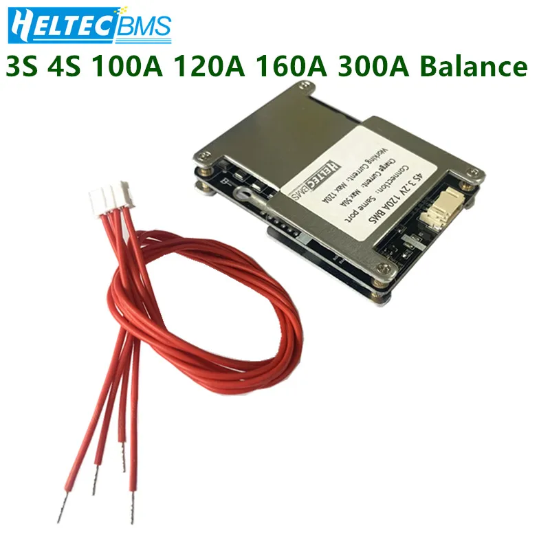

For 4S packs you will be hard pressed to find a High Amp FET Based BMS. Heltec only has TWO Smart 4S BMS'. They have 8S+ which can also do 4S which are higher Amp capacity but they have to be checked to verify which is suitable.
Daly make a 500a smart BMS. Heat sink looks huge with a fan. I was considering purchasing one .
