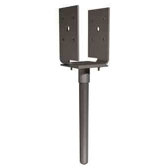

I guess those pier blocks have something to tie beams into. The ones I usually see don't, just stack the deck on top.
I've used metal ties that get set in post holes I did, but I also loop rebar around them so tied in to concrete full depth.
Yes, like this which screws into the concrete block:
