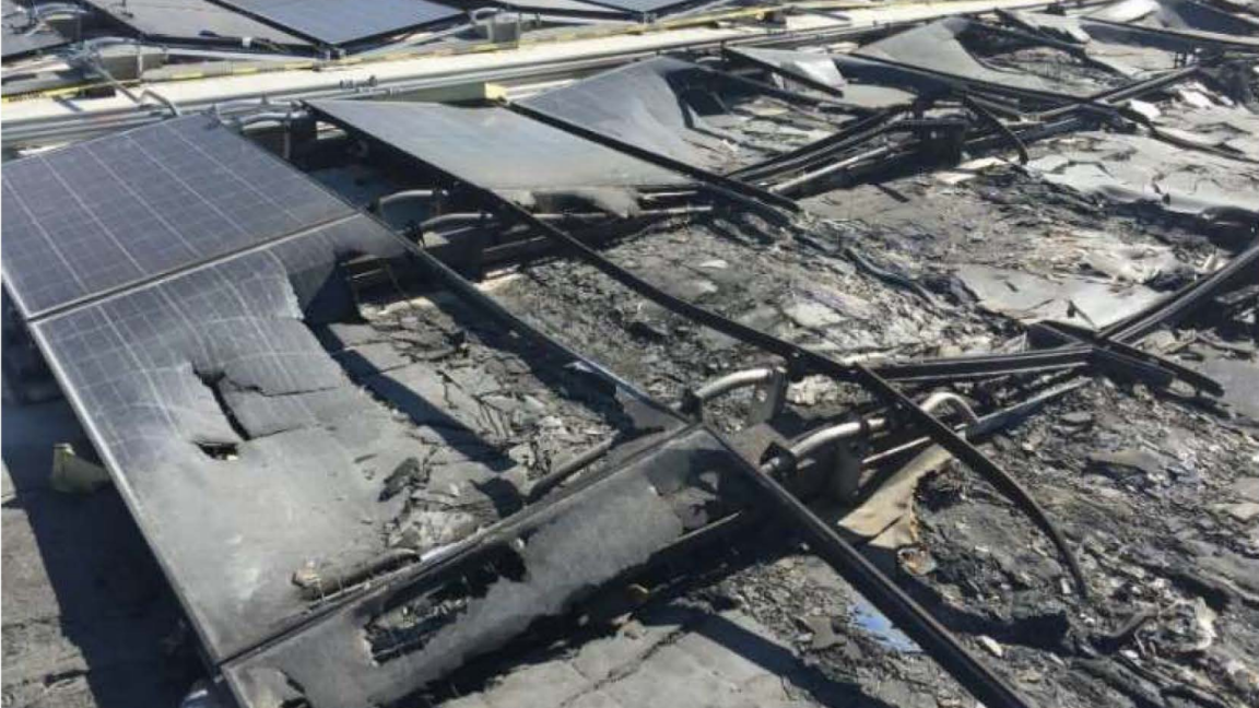

The worst possible case with PV panels is when the absence of solar bypass diodes causes a fire. This is possible under certain conditions, such as when a leaf completely covers one solar cell of a series string. Under these shaded conditions, those covered solar photovoltaic cells become consumers of electricity instead of producers.
This means that while the rest of the solar cells are trying to pass current, the shaded solar cell is drawing current. The byproduct, of course, is heat. After many days of operating under these conditions, this additional heat and multiple temperature cycles can cause a fire.
This scenario must be avoided at all costs. Therefore, solar bypass diodes are required in all solar PV panels that are certified for use in the U.S.
This implies it's NOT a good idea to block off portions of a panel to reduce the power unless diodes are being used.
